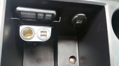

So, went camping this weekend and 2 things happened; I ran short on outlets, and I had to keep my truck on ACC to charge my stuff. So, I fixed that. Added an aux pack I got at Wal-Mart. I wired it to the red wire of the larger harness for a constant on, then wired it to the black wire of the current DC plug for ground.
