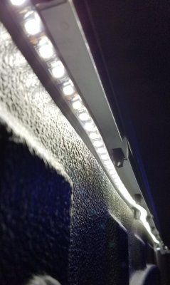

Has anyone added bed lights to their ram?
I have a 14 express with no pre drilled holes for the factory bed lights.
I was thinking about adding the light strip stick on under rails wiring into the cargo lamp circuit. Has anyone done this?
Recommend a different kit ? I think it would be easier to go into trailer light constant 12v with a switch in the back but not sure where I would mount switch.

Above is everything I used. First I wiped down under the bed rail with alcohol the used the primer pads so the lights would stick good. I mounted the switch in the box then to the drivers side at the rear of the truck where my toneau cover handle is (same area). I dropped wires down and picked up the constant 12v from my trailer hitch wiring up to the switch then out to the lights.

I put LED strip lights under the bed rail of my buddies 2500 that has an 8' bed. I wired the power to the trailer 7 pin +12V, his truck has a fish wheel prep but it's the same plug on the bumper. I put a safety switch under the bed rail in a small plastic enclosure mounted with 3M VHB two sided tape that also contains a small fuse.
