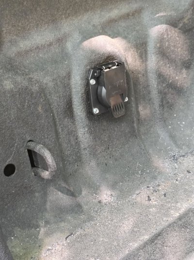

By using the 5th wheel parallel line which on the Ram there is a connector on the frame and you still have the 7 pin on the bumper for the trailer. There is a 40 amp line on booth 7 pin outlets.I used to carry my electronic cooler in the TT and plug into the 12 volt outlet there.. You can also use the 12 volt plug and plug in an inverter if you need 110 volt. Just remember with the source power being 13.8 volt you will only have 552 watts for the inverter not the 1000 or more that is on the label.
That's 4.1 amp for the inverter.. Lots of power to run the cooler..

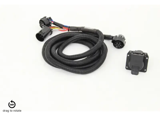

See my post #7 above for a kit to add what he's talking about.

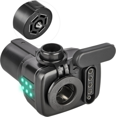

So to get power in the bed I added a 5th wheel wireing harness and then got a fancy adapter from Amazon.

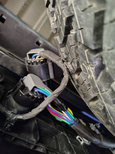

The install went well, I did pop the factory 7 pin out of the bumper so I could get the wire connector apart.
the tee installed..............................................................it's along reach up to mate the plug and connector

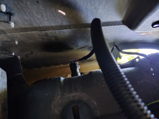

a close up of the rear install and connector...........................the installed 7 pin trailer connector

Here’s something cool, just googled 7 pin to 12v cigarette lighter, then I guess you could plug in an inverter and maybe run a few things. But for your cooler I think this would be the way to go?
Worked great inflating bike tires this weekend! Truck didn't need to be on to run the compressor.
