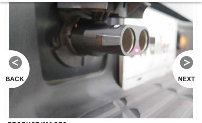

Here’s something cool, just googled 7 pin to 12v cigarette lighter, then I guess you could plug in an inverter and maybe run a few things. But for your cooler I think this would be the way to go?

I need the 7 pin for my trailer. My intention is to keep my food cold in transit while towing my TT. I’m not inclined to use my TT fridge while towing so the cooler works. I’d like to keep it out of the passenger cab, thus the bed outlet. Maybe I can find a four pin adapter.

Buy a gooseneck/fifth wheel 7 pin plug kit for the bed of the truck. It parallels the connection on the bumper to the bed so both connections work.

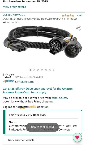

You can go this route and pull from the constant power from the harness. This way you aren't cutting into any original wiring. I used this for my LED taillight bar. The trailer plug is also pretty high AMP I believe.
https://smile.amazon.com/dp/B0009FJ38Q/ref=cm_sw_r_cp_apa_fabc_DNQPFb2VZ41W6?_encoding=UTF8&psc=1
Sent from my SM-N975U using Tapatalk
I don't think that will get him the constant 12v he needs, just lights on the 4 pin
Sent from my SM-G970U using Tapatalk
Edit: I just reread that, I guess you meant he could splice into this instead of the factory harness.

I was thinking about splicing into the constant 12v on the 7 pin trailer connector and going to a cigarette lighter socket in the bed, but I'm cheap. This looks like a good no splice option if he doesn't mind spending the money.
No, splice into the 7 pin part of the harness. The flat connector is just a bonus.
1 oclock position = 12 volt hot lead
3 oclock position = right turn/brake light
5 oclock position = brake controller output
7 oclock position = ground
9 oclock position = left turn/brake light
11 oclock position = tail and running lights
Center = reverse lights

Yea, I realized what you meant after I reread your post, I went back and edited mine.
