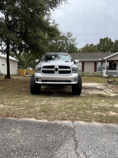

Hey guys, so im totally new to the lifted scene and the forums so im not sure if this has been discussed yet. I'm currently on a 7in maxtrac lift and 3in body on 22x14-81 and 40x15.5 and im not satisfied yet and was curious what more i can do to lift her up. ive seen some people run spacers with there 7in lift and they said it rides fine, so i was thinking instead of running the spacer could i order a bigger spring instead? or what else can i do to lift my ram? i have a diesel truck that i would like to keep mostly stock and thats why im doing it all to the 5.7l

wasn't sure how to reply earlier but i sent some attachments of my current setup!

Yup that suckers is at the MAX. Sweet ride!
