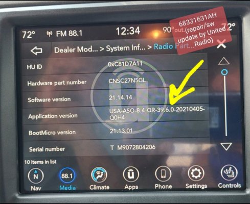

I just had a customer get a bad radio from elsewhere they had to get repaired ... United Radio got em squared away and apparently loaded the radio with application version v39.6 20210405 as part of the repair (missing Cellular modem/gps board)
And it appears to work well.
I've got no idea how to get our hands on it for others to try the update, since it's not officially released by Stellantis...
@ClearlyStabile ??
@ClearlyStabile ??

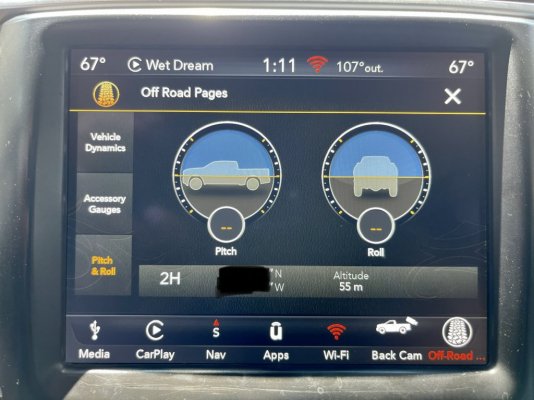

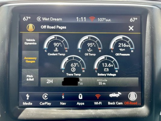

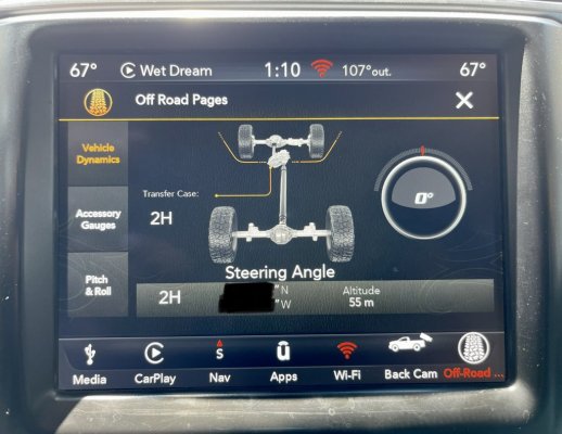

Just found this thread and updated my UAQ to 39.5 from 30.24. This update fixed the Sirius XM not working on previous versions, and the audio quality is great! Plus off-road pages now work too. Steering angle changes as you rotate steering, transfer case sees change to 4x4, coordinates/altitude changes as you drive, and pitch/roll haven’t changed but I’m on flat ground.
I noticed “installing off-road pages” & “installing performance pages” when radio rebooted after update. I enabled them with alfaobd and it worked. Performance pages loads but gives an error, I might have to enable SRT for it to work.
Does anyone know how to change the settings for off-road pages? I want to see if I can change the gauge units from c to f.
888D62B7-8453-4579-840A-1F43C08B6BDE.jpeg158DF3F1-BD32-4BE7-A622-CAF7938B1B86.jpeg9DDAACB0-B43A-4FA6-AEFB-D5295534DE69.jpeg
View attachment 469524View attachment 469525View attachment 469526
