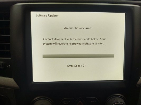

Does the files need unzipped? I downloaded the 39.5 file and copied the files to the USB stick. Get error 01.
Thanks,
Earl
Thanks,
Earl

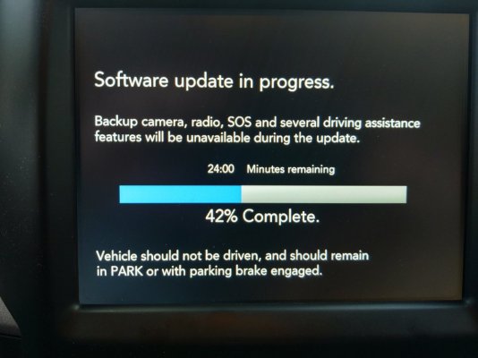

Seems to be working now. I reformatted the USB stick and reinstalled the software.
