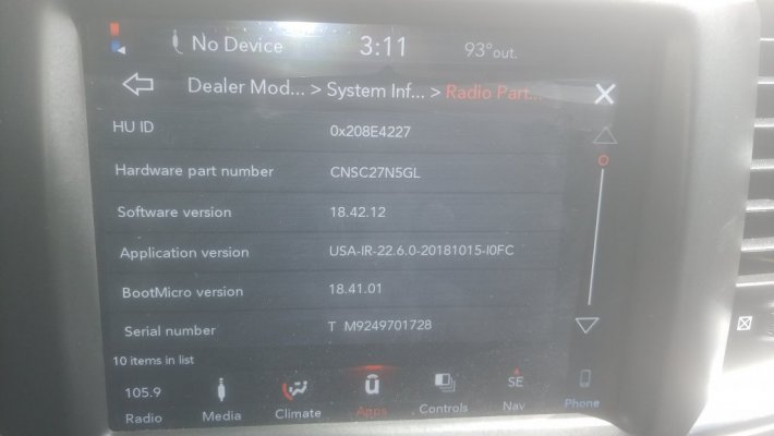

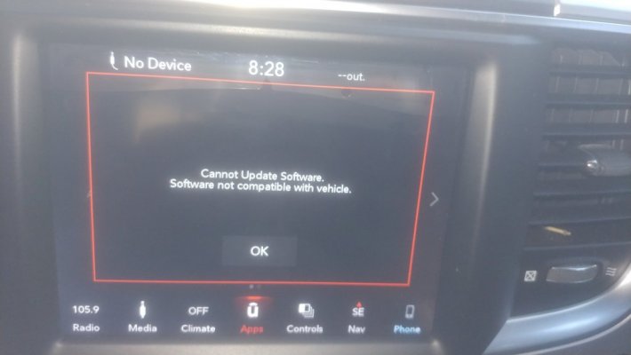

I've tried flashing the new 39.5 firmware update on my UAQ but would not proceed forward. Is there something I'm doing wrong?
SitKneelBend
Jan 8, 2015
9,059
4,745
St. Louis
3.6 Pentastar
What, if anything, occurs when you try to update?

Alright here is another picture
