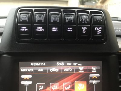

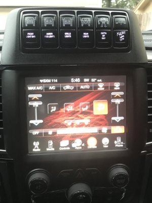

Over the year I started adding more and more electrical items to my truck so I decided to add the AEV 6 position switch pod part number 30601000AA to the dash. I designed a schematic, ran it by @IRSmart a few times to check my plan and started ordering the parts.
https://secure.aev-conversions.com/shop/products/interior/switch-pod-for-ram-trucks
The power distribution box is made by littlefuse HWB60 and worked well. I ran the trigger wires inside the fender like the other oem wires are.
http://www.littelfuse.com/products/...modules/hard-wired-pdm/hwb60/pdm21001lxm.aspx
The switches are from OTRATTW (Over The River and Thru The Woods)
https://otrattw.net/LOWER-INDEPENDENT-LIGHT-UPPER-DEPENDENT-LIGHT-SWITCH-ONLY/
The rockers are Contura XIV, they have a good feel to them and have a "separation" molded in to distinguish upper or lower.
https://otrattw.net/CONTURA-XIV-ROCKER-ONLY/
I used @kad method of entering the cab via a rubber boot.
http://www.ramforum.com/threads/ins...nning-wires-into-the-cab.117923/#post-1696482
I routed the wire bundle behind the head unit and up thru the top of the center stack. I then added the mating connector to allow easy removal of the switch pod.
