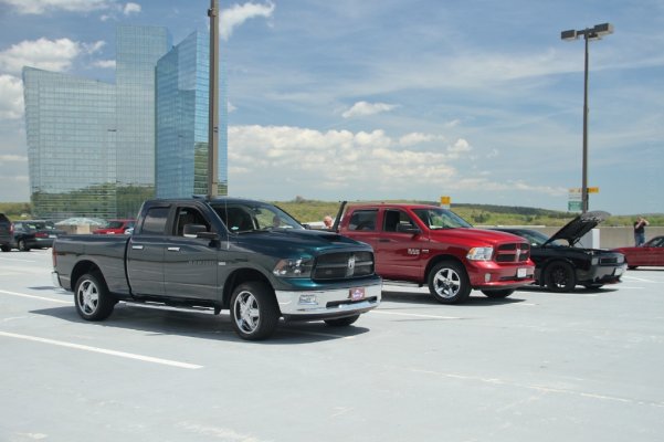

The whole works don't work and how well is always dependant on a completely sealed system off the top. As of now I know of no one who has figured out to seal the hood to the intake. That being said the whole inside of the hood acts like a low pressure zone. If any air does flow in at velocity it is slowed there. When you slow fast moving air you increase static pressure. The problem is at the hood/filter for real ram air. At any rate, it looks mean in people's rear mirror and looks sometimes is performance.

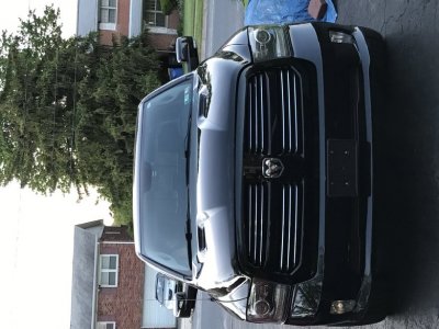

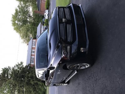

Just installed amerihood
Definitely slight fitment issues. Passenger rear corner of hood needed shaved 1/4" or so. And both front corners were very high. Had to raise fenders. Overall looks great. Feels sturdy.
