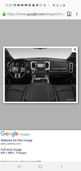

I screen shotted the difference.e585b31c3fa05fc09ca682d2facfef57.jpg481ca6b1a19966eaeb24b4973464dae1.jpg1de4ea17c903eb72bef82a66bd664556.jpg

Oh yes I've seen them all before, so are you questioning what kit on the maestro site would work for yours? And it's giving you options for 4th/4.5/5th gens? Or just 4th/5th? Sorry I'm a little confused as to what your original question was. Seems like the 4.5/5th should be exactly the same since the new HD's have the same interior as the 5th's.
Looking back at your original post, the maestro site said it worked on a 4.5 gen for that CH-3? Or did it say 4th gen? Cause the 5th gen was out for about a year before the 4.5's so you would think they would have made a product for the 5th gen before the 4.5. I apologize if I'm missing the objective here, I'm not much of an audio guy.

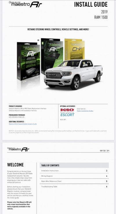

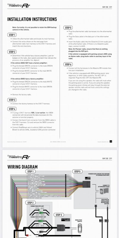

They must be mistaken for the 2500/3500 that they have together as 2018-2019. I don’t think the issue is with the maestro. The cameras on the 5th gens and the 2019 2500s are digital, and use a single coax cable, as opposed to the analog signal the previous cameras used. I don’t think any aftermarket radio is capable of displaying the image from the ram’s camera.

Oh man what a pain in the ass... Has to be a way to convert it?
