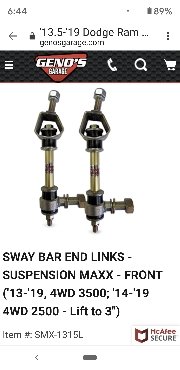

I'm am going to level my truck and looking at front sway bar end links.
Saw these and was wondering what's with the cage on top?

lots of people using them. The “cage” is just a mount used for to attach the rod and bushings instead of using a ball joint like stock. I’m still using stock on a 3/1 lift level and no issues. If I change I’ll end up building my own with heims or sealed ball style bushings instead of those for personal reasons.
