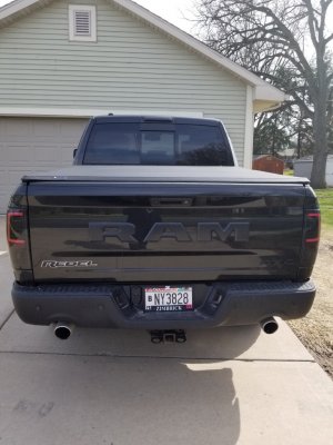

I recently purchased smoked akkon led tail lights and Im experiencing hyper flashing from my dash and mirror signals, but not the tail lights. All lights work even though I get a message saying rear signals are out. Any suggestions on fixing this?
