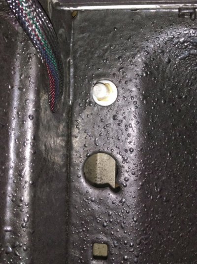

I have mine installed inside the bed, near the top through an existing hole. That wiring you see goes to my cap lighting.
