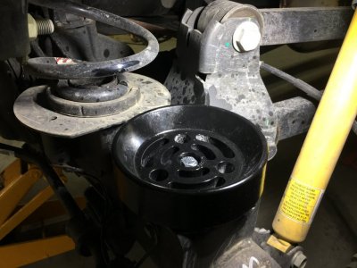

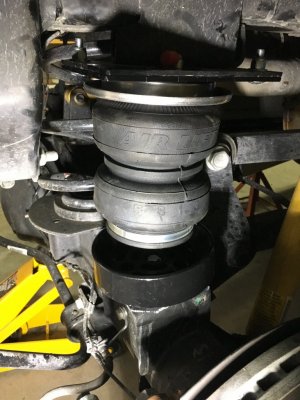

Very happy with my choice! Compressor is in floor compartment behind driver’s seat! Remote sits on the dash!
price was right, plus $150 rebate at the time!
installed Daystar cradles and bags at home! Pretty smooth install!

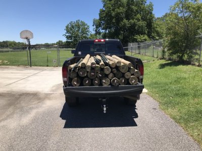

This is with 40 PSI in the bags and I’m guessing around 2500 lbs in the back. Truck handled the payload perfectly so very satisfied with Air Lift.
That is what I wanted to see - right there. For the most part, mine will be a Farm Truck too - but we have some nasty hills and mud in some of the pastures. Other times I will be towing heavier loads (tractor, travel trailer, bed full of round posts, etc).
Airlift it is...
