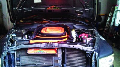

2003
Doesn't matter, it'll fit if you make it fitunderhood snorkel.jpg ! 4th gen Vararam I re-engineered to fit my 3rd gen and fabbed a custom snorkel to go with it.
