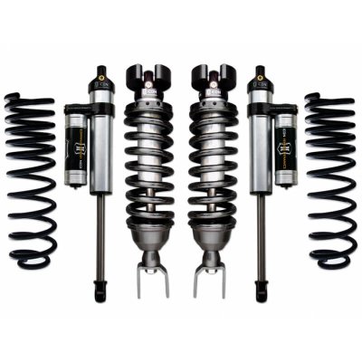

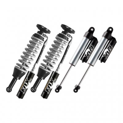

Been reading on the Rebel forum about converting the air suspension to a conventional coil over system. After many hours of searching and reading reviews on the web i have decided on the 2 best systems without having to mortgage the house (King). Anybody else had any experience with either of these. The Fox is supposed to ride a little better and the Icon is a little more off road but still a solid choice from whats been reported. I need to call Fox to see if i can get the rear coil springs to go with shocks. Luckily my air suspension has had zero issues so far, but i want to have a plan just in case
Icon Stage 3 $2600
Fox 2.5 $2650 without rear coils

@Nick@GotExhaust is the vendor for both on here. See what he can do for pricing.
As for which is best for you. ...what are you doin with the truck? Fast driving offroad, trails, jumps, mall crawler with some performance.....theres alot to it. Budget constraint are big too. End of the day, 3k is a good bit of money. Icon is an all included package, which is really nice. Fox and king is just shocks, so you need to add rear coils and UCAs into those packages as well.
As for reviews, @bruiserRAM has a few in depth icon reviews. Haven't seen much from fox in depth but I know @novelmike upgraded to 2.5s but is busy with a new house. Don't forget at that price point, you can get a set of king 2.5s as well. There's 3 different quality lift coils for the rear available. Bilstein, icon and eibach all are priced well and available separate from the kits.
Main difference is in the valving profiles. Icon is digressive, fox progressive, and king is progressive. All provide very different ride quality characteristics.
