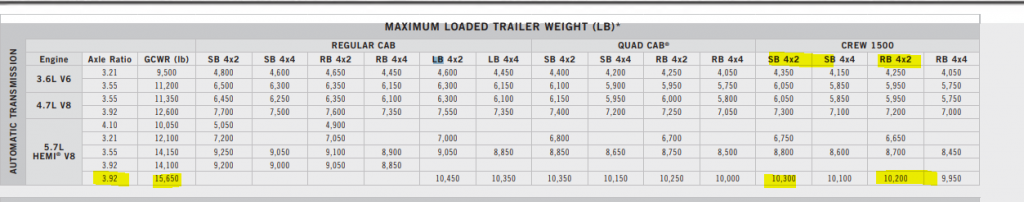

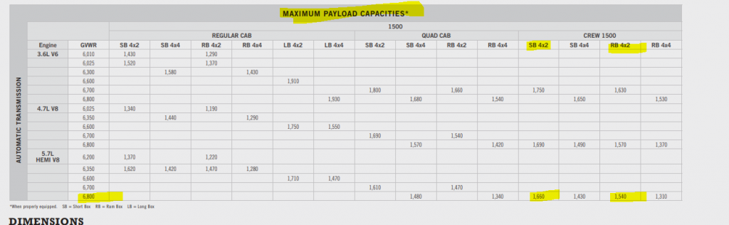

looked on door panel (tire and loading information) and says occupants and cargo should never exceed 1278lbs. why isn't this matching the spec sheet below of either 1,660 or 1,540 payload?
this is a 2013 ram laramie 5'7"crew cab 4x2, 3.92 axle, 5.7L Hemi V8.
the gawr on the other sticker on the side door matches the specs of 3900lbs front gawr, 3900 rear gawr (20inch rims) and gvwr of 6800lbs
from the spec sheets for payload and trailer weight:

It doesn't match because the spec sheet is for that vehicle with no options other than the powertrain configuration. Because you have a Laramie, you've got a decent load out of options that a Tradesman doesn't have. Every little option added to the truck takes away from your rated payload.
Be glad you don't have a fully loaded Limited...some of those are down around 1k for payload. You technically can't haul much more than 4 full grown adults.

as mentioned above it the added extras on the truck that reduces the payload. The air suspension itself lowers the payload as it requires a compressor module and air tanks.
If you decide to swap to a traditional coil suspension, look into TufTruck springs for the rear, they offer versions to minimize rear end drop.
