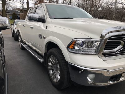

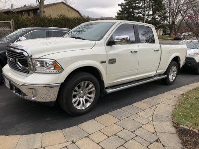

Checked the truck this morning with measuring tape and much to my surprise it didn't drop and it's the same height on the passenger and drivers sides.
img_1058-jpg.149524
img_1057-jpg.149525
I'm a happy camper with my fingers crossed. Service adviser told me they had reached out all across north America looking for help with no response. The engineer that my mechanic worked with was the key to getting this fixed. Once I opened a star case with FCA the dealership had full support. I've post their findings from last 4 weeks in the shop. I have more reports but they are a mute item now.

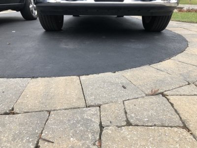

Surprise , surprise... my suspension has dropped the last 2 nights. Looks like I'm going to have to dump this truck. At this stage in my life I don't need this aggravation. I said to my wife yesterday that if we don't get rid of it we'll be plagued for the rest of ownership. I'm really pissed off with this whole go around.
