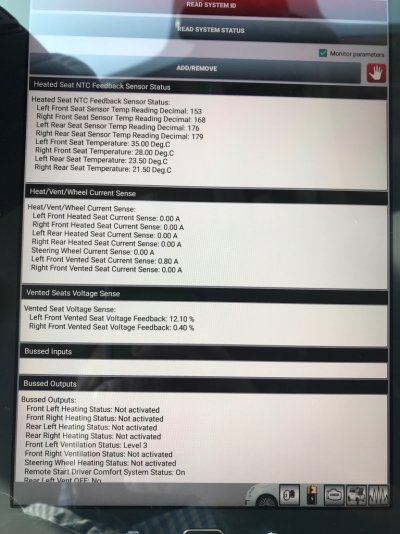

Have you ever connected to the climate seat control module? (aka heated seat module)
If so, are there actually data points you can monitor, like the sensed seat temperature, the amount of current/voltage going to the heating pads, etc?
I haven't done much testing with the AlfaOBD like ghost_ram Ricks_Ram & DeereGuy have (been busy with orders). They may be able to give insight.
M² Mods.
To my knowledge no one has completely set the heated/vented seat with only Alfa. I'm totally willing to test, maybe a fund can be setup to purchase me a set? Lol
As far as monitoring data, I haven't heard anyone doing so but if someone has hopefully they will step forward.

Actually its a little bit unrelated to getting the seats to work...was curious if there is a way to find out what is happening with @firemedic10584 's heated seat issue. Granted, he is in lemon law right now, but my curiosity is piqued - the system is shutting down for some reason, and there arent many reasons why it would, so could we actually read the data from the heated seat module and determine why its shutting down, and presumably that would point at what needed fixing.

Oh I dont trust them either :) the thread is on here and is very long and drawn out and full of "dealers lack common sense" bs.
Anyway...I did try to connect but the app yells at me because I dont have the genuine MX adapter. It tells me I can connect only if I buy/build a harness that has certain pins rearranged compared to the standard ODB connector pinout. Nor do I have actual heated seats (although Id guess connecting to the module would at least allow me to see the possible data points, if any exist)
Ah gotcha. I just searched it out and found his story. Looking through it now.
I can't look at anything either as I have an Express with manual cloth seats. However, there are a few members with the program. Maybe someone can test.

And there we go, thanks STecoD. I definitely shows more information than I thought it would. Gives me more to play with when I get mine installed.

@STecoD - that was HUGE, thanks!
So, we really could figure out what is tripping the seats off early. So could the dealer. I wonder if they ever really tried.
You never know what tools they actually have available to them. I do know the module is like $70 from an online retailer so if they haven’t tried to replace that they are wasting his time.
