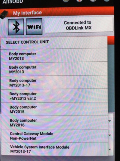

Rick hit it. This is what I get on the screen in the controls section.
It only displays the cargo camera, which I dont have. If I hit the button I get this.
I can then select the reverse cam and it'll come up on the screen just fine. It doesn't matter if I'm in reverse or not, but it does cut out in motion pretty quick.
I was thinking about disabling the Nav lockout it the truck and seeing if maybe the backup camera will stay on because the motion lockout is disabled. Probably won't but worth a try .
