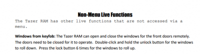

I tried a bunch of different configurations with the lock button but nothing worked. I would assume it would’ve been a lock then press and hold.
for this have you tried hitting lock button six times?
I attached an image from the tazer RAM user guide found here: https://zautomotive.com/zpu/instructions/tazer_RAM_user_guide_12.0.0.pdf
I'm not by my truck currently so I cannot test.
Will do so later and report back if no one else has.

Just tried this on it did not work on my 2015 2500 Laramie
I’m assuming you do have global up set via alpha? Not trying to be rude, just confirming.
No worries, now I have to check, when I first did it, I thought I set both. Standby!

This only works with the Tazer module. It has to be plugged in all the time for this to function.
Oh ok. Thanks. Oh well was worth a shot. I figured that being how the down was the same key sequence, the up might work.
Well, it wasn't set. Disregard. I set it now and gotta let the truck take a nap or two.
