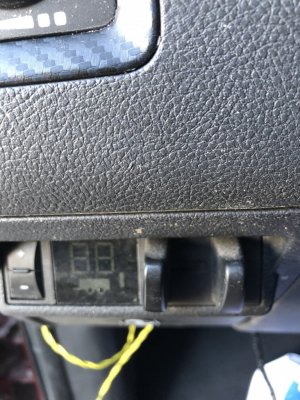

2F389547-4090-4CC2-AEE3-D8823F486912.jpeg 27D3A0CE-BB21-4BC5-9D6D-4BBB634AA964.jpeg 4D493767-AEE8-4D4F-8CB6-B38973F4773D.jpeg Ahh well crap! I saw 2009 + 4th gen Ram.
However on a side note I did connect to the other modules by tapping into the Can hi and low 125k lines and disconnecting pins in my obdii and placing can hi and low in accordingly.
I also was able to add my ITBCM successfully and shows on my evic now!
It never came with the ITBCM and wasn’t wired for it. I wired it in and works find. Now shows on evic. Of course in picture I do t have trailer hooked up I’m just pressing the levers.
So hope this helps someone!

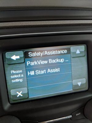

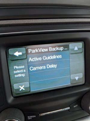

So I got the update, and started playing to see if I saw anything different. I was able to activate radio apps, and now I have the back up camera selection on my RA2 which strangely I didn't have after the dealer flashed the sales code. I screwd up playing with the instrument cluster. I selected fleet I'd reset ,and my truck became what looks like German I freaked out. I was able to get the units back to US measurement, but language was still in German. I grabbed my owners manual, and start to go inside to see if I can figure out how to get it back. Then it hit me to see if I can locate the language selection. When I went back in the truck, and turned the key on. The EVIC went blank for a couple of seconds and came back to English phew!
