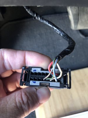

The thing I find odd and concerning is it says that if I’m not using the OBDLink MX that I need to use the blue adapter OR make sure the cars OBD plug pins 3 and 11 are connected to pins 6 and 14 of the interface. On my truck there is no wires in pin positions 3 and 11.
I’ll attach pictures of the OBD port.
I know I could save time and just buy the OBDLink MX but now I’m not sure it will work with my 2012 ram.

Based upon my pinout of my OBD connector, and what the chrysler wiring shows I have the following.
Pin 1 NC
Pin 2 NC
Pin 3 NC
Pin 4 WT/DB Diag Can C (-)
Pin 5 BK/LG Ground
Pin 6 WT/DG Diag Can C (+)
Pin 7 NC
Pin 8 NC
Pin 9 NC
Pin 10 NC
Pin 11 NC
Pin 12 NC
Pin 13 NC
Pin 14 WT/LB Can C Bus (-)
Pin 15 NC
Pin 16 RD/PK Fused B(+)
Can anyone show me a pic of their OBDII port for a 2012 ram 1500? I believe I’m missing
The site doesn’t tell me what cavity it needs to be in but I know where I can get 125K +/- from.
WT/OR IHS BUS (125K) (-)
WT/GY IHS BUS (125K) (+)
According to the connector repair site for mopar I should also have
But don’t have these wires either.
BK/TN Ground
WT/LG Can C Bus (+)
