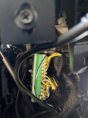

Can some one help me with my setup of the security bypass module for the 2018 ram 1500. This is my setup. The bypass security module has two plugs. Which goes where or do I only need to use one plug?
thanks

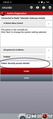

Well, (on the charger) I tried every NAV lockout related setting I could find and hit the security wall. Its a 2013 R/T and I'm hoping the security system is the same as with the trucks and can be defeated.
We used a OBDLing MX+ interface.
thanks
You will need both plugs. There are two Block into which the wire will plug. The plugs are different, so you cannot plug the wires into the wrong Block.
I had to really search around to find the second Block on my 2019 Classic (it was facing forward and not readily visible).
Hope this helps.

Ok thank you.. will they both be on the front side by side or on the back?

My 18 ram1500 ...
See the green block and the white block.8fad4a84e449a0cb0216157d8fe5d512.jpg
