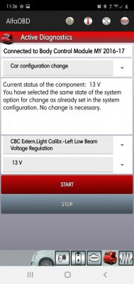

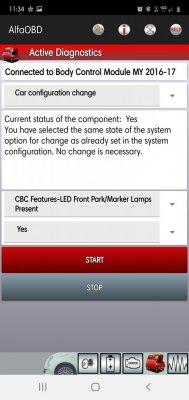

Quick help please
2014 Express install aftermarket headlight with H13 dual low/high LEDS Bulbs
AUXBEAM H13 LED from Amazon
I get a Passenger side High is out.
Used Alfa flashed both High and Low to Yes but still high passenger side out.
Is there something else I need to do
Thanks
This was the ticket for me to still get lamp out warnings when I was supposed to. Youll have to do left and right obviously, highs, and lows, I did the corners as well. I dont know if that helped. But it didn't hurt anything. DRLs are set at 7.4V. That is a huge topic in its own right.

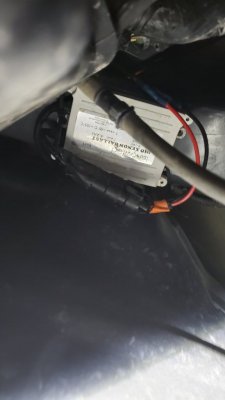

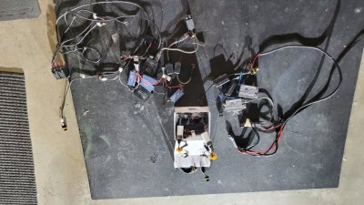

I have a 2015 1500 Express, swapped my headlight housing to projector style (built in electrical and wiring to connect to the stock reflector plugs no harness needed) and added the MOPAR Morimoto harness/ballasts/HIDs for low beams. I also have LED fogs, switchboard LED turn signals / running lights (wired to the battery and an add a fuse for signal), LED marker lights (integrated in the aftermarket housing), and LED high bulbs.
Everything worked fine for about a year then my low beams would shut off for half a second and immediately come back on, would happen every minute or two. No CEL, no warning, just pop off and back on intermittently. TRS sent me out a whole new harness (4x resistors, capacitor, 2x relay) and everything worked again for about a month. It started doing the same thing of shutting off for a split second then coming right back on.
Bought ALFAOBD and turned on HID in the vehicle configuration settings, unhooked the HID harness completely and had a bulb to igniter, igniter to ballast, ballast to extension cable, extension cable to factory plug setup. After doing that my low beams would not turn on at all, still no CEL or error on my dash. Tried turning on LED low beams, BI Xenon, Quads on/off, LED/HID on together. Never got a CEL but the bulbs also never came on.
Put everything back to stock on ALFAOBD, hooked the harness back up, and everything works again now (but I suspect the lights will still continue to randomly shut off once I actually get on the road for any length of time).
Anyone got any input on why the HID setting seems to have been completely ignored by my 2015? It was enabled per ALFAOBD, but my truck didn't seem to care. Or any recommendations on how to stop my low beams from intermittently flickering with the TRS MOPAR harness?
How many pins are in the original connector compared to the projector? May force you to set as quads. My experience is the 2015 is a finicky ******* compared to all the others. And Morimoto is over hyped crap. Ive tried 2 generations with 2 different set ups in 2 model years. Now they both have the Amazon crap 55w Innovited Ballast/ignitor s with 6000k lamps for about the cost of 1 XB ballast. Parts anyone?
