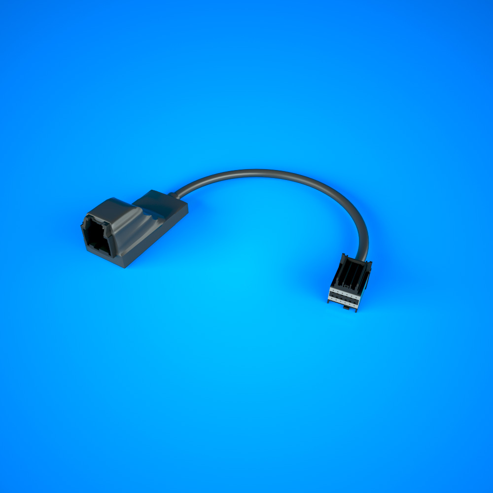

Can anyone enlighten my on what this bypass cable is. I tried to have a local neighbour do the foglight drop out on the wifes 2019 Challenger,that's tuned utilizing HP's bypass cable,but he couldn't link to the car. Is the AlphaOBD bypass cable a specific cable,i was under the impression as long as you had a bypass cable in place,OBD would work on the newer vehicles,but apparenly i'm wrong.

Now i'm wondering. The HP cable doesn't plug into the obd port,it actually plugs in on the back side of the radio.
I think your barking up the right tree. The typical bypass "cable" is basically a jumper around the security gateway so devices can write to devices on the vehicle comm busses. That HP cable looks like it attaches on the comm buss behind the security gateway to allow direct communication on the comm bus.

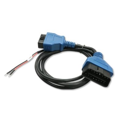

Didn't realize HP bypass was different.......fairly certain you would need the bypass that works with OBD port for AlphaOBD.

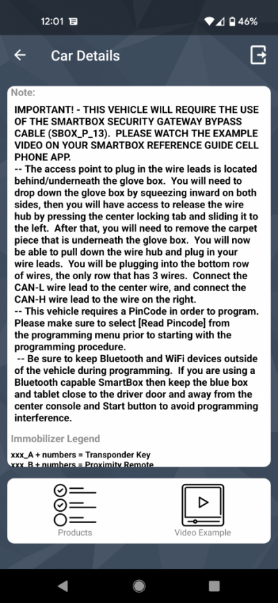

OBD port bypass cable is what I use with Smartbox for programming key fobs

So I just purchased a bypass from ECRI. I don’t see where to plug it in. Does anyone have pictures and a good description?
