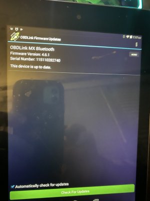

It updated on one part and don’t know if the other one spouse to. Here’s some pics
