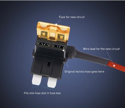

Yes. I think f66 uses a 10A fuse so that would go on the bottom of the fuse tap. Not sure what goes in the new fuse tap slot. Another 10A fuse? 15A? 20A? As alpha rex states connect between 10A-20A. Sorry, guys I don't want to mess up.
And I’m pretty sure it’s a Micro2 Fuse Tap, but someone correct me if I’m wrong

I believe the fuse tap is a single fuse. Basically the bottom part looks like a fuse, that goes where the fuse was, then depending on whether you get one with a built-in fuse or a empty cavity one, the existing fuse or replacement fuse goes in top and the wire coming out is your keyed on power source

The fuse taps have the bottom that fits into where the original fuse was. Then there are two slots on top. The bottom slot is where the original fuse which is a 10A if using F66 goes. I’m just confused on what would be the correct Amp fuse to use in the top slot. In order to protect the new circuit. Some people say that one of them should be higher others that it should be the same. So I don’t even know. B0EB9A27-51CD-4379-B20E-714EC7FFDDD8.jpeg

Since it's only to turn on the drl's a 10 amp is more than enough. Lots of people have just stuffed the wire into the fuse opening. I believe f66 is for a sun roof.

I've seen that. But I don't know sounds kind of sketchy to me lol. I guess two 10A fuses it is.

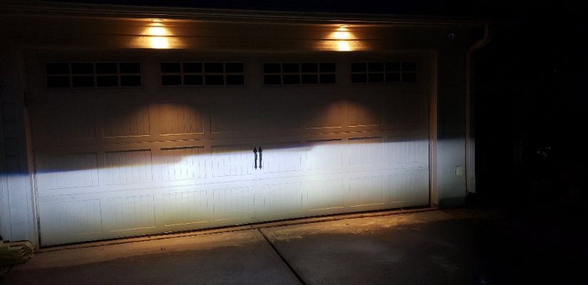

Those will be absolute trash. I believe those are the same design as the original Hikari (non ultra). The diode size and placement is wrong, and it will give a horrible light pattern, especially in a projector.
Hmm, reviews seem positive though. I had already ordered (although not received) and will give them a try. Amazon returns are easy if they suck.
Supposedly the reason the original sucked is that its expecting one "dot" of light, but the originals were a full 0.2 inches apart top to bottom. These are only 0.06 inches apart, so should be more on point in theory.
I usually prefer HID, but being non-bixenon means that wouldn't really work for highbeams at the least.

I saw there's a new listing for 2020 Hikari (non-ultra) that seem well reviewed.
I saw those a while ago. They look similar to a set of opt7 led's I have. Sucked for low beam in quads. Never could get a good beam pattern. Work great as highs. Biggest reason is the spacing of the led's. From your other post the Hikaris are narrower so that should help
