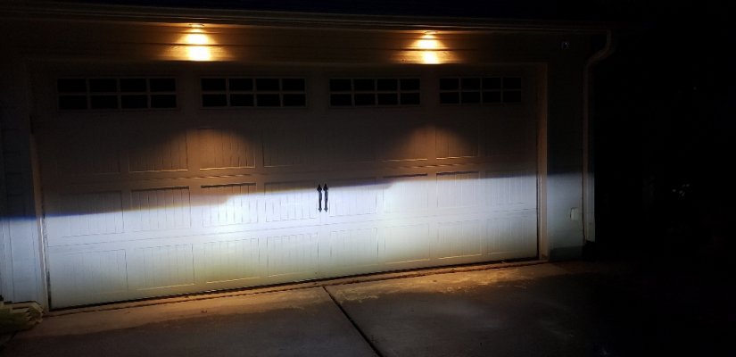

I received the 9005's today and was able to fit them into the H10/9145 fog lamp housings of my 2009 Ram without much difficulty and did not modify the base since I wasn't sure if I wanted to keep them.
Edit: I am not keeping them, they are SUPER bright, but its almost like driving around with highbeams on with how much light spill there is when I do a wall check. Doh! So the headlights lows and highs stay, but still on the search for foglamps.

Are those the Hikari Ultras in AlphaRex G2 Pro low beams? Or are those the regular Hikari's you're talking about? That beam pattern is on point!
Hikari 2020 (the ones with the domed LED, note the ultra) in these projector housings: https://www.ebay.com/itm/283395072277
They supposedly have an improved Hikari 2021 model now, that may be a better option. Didn't exist when I bought mine.
