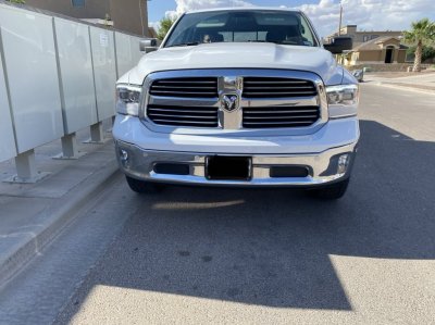

Got the Alpharex headlights installed yesterday. Love the look. I'm not sure if they are G1 or base versions (DLRs on top only, non sequential turn signals) but I didn't get any error messages or hyper flashing on my '19 Classic Bighorn. I didn't install resistors. So far it was plug and play.
They look good on that truck ... good stuff my friend
