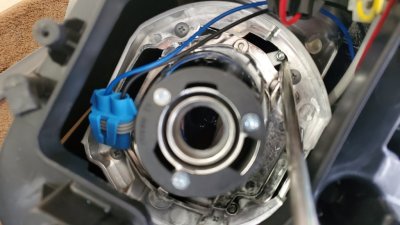

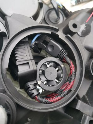

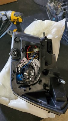

@Jimmy07 is correct. Here are my retrofitted alpharex projectors. I'm using morimoto mini h1 7.0 projectors
Not all projectors produce the same cut-off. Some are steeper then other's. It took some getting used to after my retrofit. The stock alpharex projectors had a more gentle cut-off compared to the morimotos I used. The ds2 projectors have a more "oem" cut-off. Your headlights have a taller cut-off then most. So it's more obvious then stock. As Jimmy07 said, oem projectors lense blurs the cut-off so it's more of a gradual fade the a sharp line.
99 percent of aftermarket (ram) headlights are designed for dual/quad headlight set ups not for oem projector truck's. So an additional external adapter is required. It's cheaper than producing 2 versions of multiple headlights. If you wanted oem projectors on a quad equipped truck you'd need an adapter that would be external with resistors. Only way around it is to do what Jimmy07 did and buy the complete projector headlight wiring harness to replace the existing.

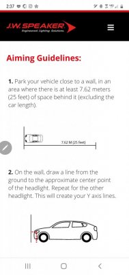

You are correct about the aim. So this is my crap housings at normal ride height aimed with the 25 foot method. Cut off is at the head light center point at 25 feet on flat surface, pretty flat.
Making that other lane driver zag equal to the length of my MB C280 and my 15 Sport CC 4X4 LB. SO 40'. I dont need light that was DOT approved 1 time and then sent to China for **** poor reproduction that is no longer close to the original specs. And i can't be convinced that this is OKEY DOKEY.

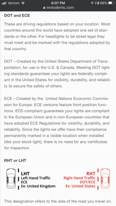

I am very curious as to what the ECE stands for in the chart. Jimmy07?

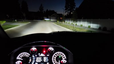

Wow, my Alpharex headlights (oe quad) are nothing like that. As far as brightness and actual projection. That’s awesome.

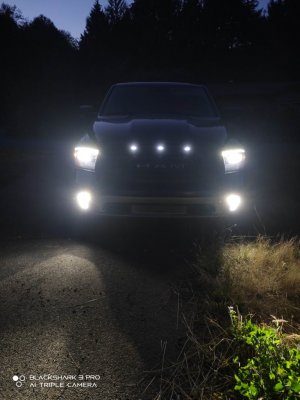

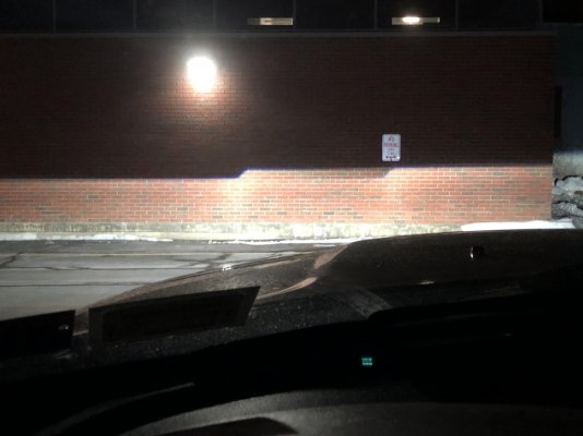

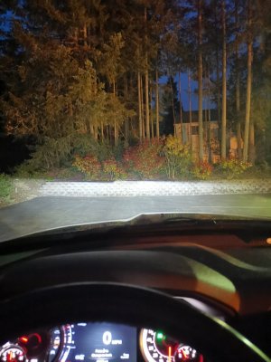

This is what I get out of my Alpharex Pro headlights. I had factory quads.
DamnRam1500
Sep 19, 2016
378
187
New Hampshire
2016 Ram 1500 Express 4x4
That's a pretty good output. I haven't yet driven at night since installation a month ago nor have I aimed the lights or if I need to.
this is right out of the box so hopefully yours are on target too.
