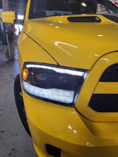

Ive just installed these but i have an issue. When the truck is in park they look great. Top and bottom light up the way i want. But once i put in in drive the highbeam comes on at resuced intensity. What do i need to do so that my DRL looks like this at all times?
Sounds like your high beams are set as your DRLs. Check in the radio as there maybe a setting to turn them off, if not you'll need to use AlfaOBD to turn them off.
You could also add the actual DRL circuits to the headlights. If your truck originally had projector headlights then the circuits are already at the headlight plugs, the Quad style headlights do not. Here's a couple of threads to help on what's needs to add the DRL circuits:

When i installed the alpharex lights i ran the dedicated drl circuit and fuse tap.
your probably describing it wrong, either you use the dedicated DRL circuits from the truck or you use the simulated "DRL" relay that wires to a fuse tap but you don't use both.
The trucks DRL circuits will turn on when the vehicle is in gear and the parking brake is not set. The can also be set to drop out when the turn signals are activated.

Sorry for any confusion. I have a classic express so it came with factory quads. As my truck does not have a drl circuit i wired according to alpharex instructions. So that means on ignition the top and bottom led strips stay lit. I need to figure out what to change in AlfaOBD (first time user) so that when im in gear the high beam doesnt come on which it currently does
Read through the first post of the AlfaOBD thread: https://www.ramforum.com/threads/alfaobd.123982/
There is a "Known Working List" link, the settings for how to enable the DRLs are in there, just disable them from the same setting(s). You could just enable the radio menu option for turning the DRLs On/Off also.
Adding the DRL dedicated circuits to your truck is easy and would make the headlights look more "factory".
