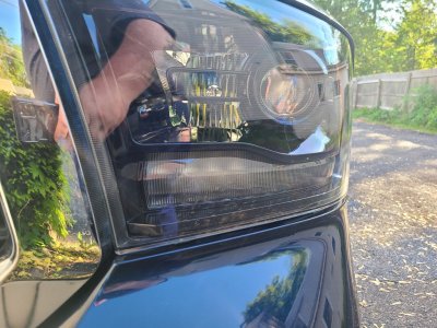

So, I saw a few positive reviews for these lights on some of the Facebook groups. Seeing as how I really prefer the look of the oem projectors, I took a shot and ordered some off ebay. 279+tax shipped. I ordered up so new hid bulbs, a set of h1 led bulbs, and a set of 100w halogen bulbs since I wasn't sure how the h1 high beam bulb would work for grounding. Lights came in, and they looked amazing. Installed the hid bulb, found that it is clocked differently than the g2 pro housings I had, and verified that the bulb does indeed focus and project better in the off-canter orientation (h7 low beams). The led high beam had 2 wires, positive and ground. Positive terminal plugged into the socket, but there was nowhere for the negative since it usually grounds to the bulb housing. Saw a spade terminal on the reflector, so figured I'd pop the 100w halogen bulbs I had in instead while I make a set of adapter pig tails at work that night. First impressions, low beams looked really good. Alignment and cutoff was pretty spot on. Flicked on the highs, extremely unimpressed, especially for 100w bulbs. Fast forward to the next day, installed the led bulbs with the pigtails. Well, the reflector isn't connected to ground. So had to come up with plan b for a temporary solution. You can slide the negative terminal in next to the positive (without touching) and the lights function perfectly. Plan is to get a crimp on wire tap and use those for the negative terminal. Now, output, I'm extremely impressed. Low beam looked good, and the high beam was damn near perfect. Centered, slightly higher and was more focused to project light out further to give you distance. The led h1 high beam was a huge improvement over the halogen bulb in terms of output and even pattern. This is now the roughly the 6th or 7th lighting setup I've had on my truck and I couldn't be happier. Low beams are using the hylux 45w ballast from my retrofit setup with an hyb 6000k h7 bulb.
I honestly, can not recommend these lights enough, especially if you like the way the oem projectors look, but don't want to spend the money. Now, for the pics.

Most of the issues I read about these and the cheaper aftermarket is the led turn signals/running lights going out in short time. Given it’s a H7 projector the output looks decent. I don’t see much at the top to the right of the hot spot (cutoff line). If you’re happy with them that’s all that matters. Still love my OE sports retrofitted with FXR 3.0 and 50w morimoto elite ballasts and 5000k XB bulbs.
Hopefully the black paint on the shroud doesn’t bubble off from the projector heat. TYC used to be black but they had issues so they leave the inside of the shroud chrome and I think retroshop does the same thing.
