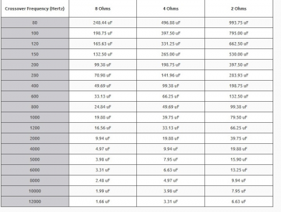

Here is a capacitor roll off chart , looking like 47mf cap would work nice for 3.5" and a 3.3mf cap for tweeters

That's a handy chart for passive crossovers. The resistance for dB cuts is a circuit generally called an L-pad attenuation circuit it doesn't effect signal just lowers the power to reduce volume when multiple speakers are on the same channel and some are too loud such as door speakers and dash speakers in the ram trucks. More complicated to explain then I care too, but there are a lot of electronic sites with explanations and calculators to build them.

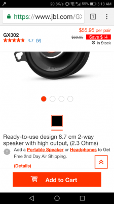

3032cf is 2ohm but see now replaced with new model. The jbl gx302 is 2.3 ohm
IMG_20180412_024000.jpg I was reading on another forum someone tested the 3022cfx and tested at 2 ohm. I have the 3022cfx in each corner and the jbl gx302, I know for sure this setup sounds excellent.

I notice most people use the kicker speakers in the non alpine system, for the alpine system since ohms are different people use jbl or infinity. I tested my oem alpine 3.5 speaker and was 2.3 ohms, same as the jbl gx302. I tested them on a meter and both were identical ohms. Now I am thinking of trying the gx302 in each corner and infinity 3022cfx in center, is easy swap to see if any different, but sounds so good now, may skip it. Thinking of 2 ohm Gto 20m 2inch drivers in the roof, but waiting on a deal, they are $119 now. I will be keeping factory amp for rest.

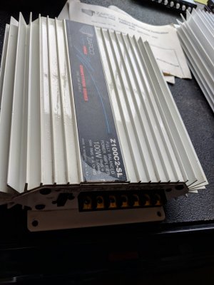

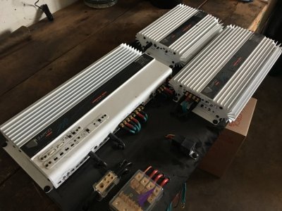

There are two higher level models of this amp (AP and LX) but this is the best value if you’re not really into car audio as a hobby or competing in SQ contests.
You ever ran a zapco? I have heard of them, they are suppose to be good. But i have never tried one.
TomT
Jul 1, 2015
1,277
560
SoCal/OC
I ran a Z-150.6 for about a year along with a Z-1KD for my sub. I’ve since upgraded again. I’m actually sitting on a Z-400.2 LX right now that I’m considering replacing the Z-1KD with.
They are solid amps and I wouldn’t hesitate to use them.
