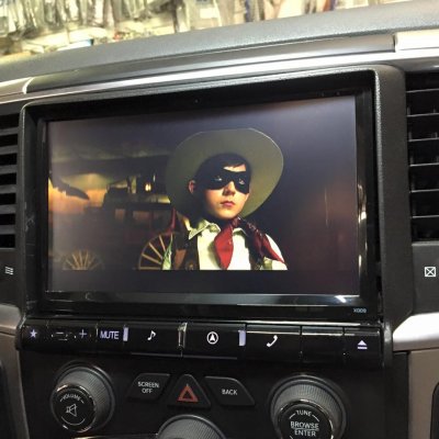

im still trying to get more details but here its done. as you can see by the heater controls its was an 8.4 version ram. he made a custom kit for the alpine 9" screen.

I Like that look.

I figured it was just a matter of time until someone made this work with the 8.4" Alpine systems.
Alpine told me the only reason they say its not compatible is because its not plug and play with the factory harnesses, but it will work if you can find an aftermarket harness adapter.
I'm assuming he used the PAC RP4-CH21.
Where did you find this, post on another forum? I need details!

its on an industry only forum (must be in the business to be apart of it)
the guy that did this is based in Louisville, KY at a store called discount audio
the only issue he found was the hvac. he cant change the location where it blows so before he removed the factory he picked a location that the customer was ok with and left it.
he used the idatalink maestro harness
