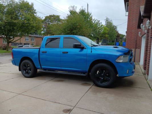

I'm at 2.1 raised on my Bilstein 5100's using the stock UCA's & stock springs all around for over four years now on my 19' 4x4 and never one issue. I'm also close to 150,000Km's of travel on my truck, too and she rides like new.
I'm running LT295/65R20 tires (equivalent to 35's) in the summer and love the handling and control. No rubbing either!

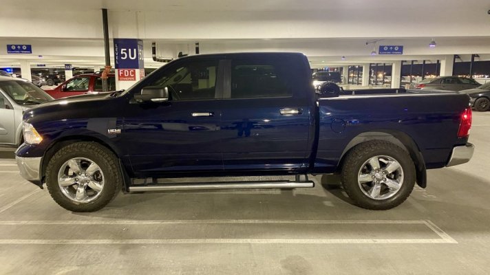

Bilstein 5100s on the middle and bottom truck. Both set at 2.8 inches. Middle photo is stock wheels on 275/60r20. Bottom is 20x10 with -24 offset with 35x12.5r20 Mazzini Mud Contenders. Didn't rub until I went with an offset.

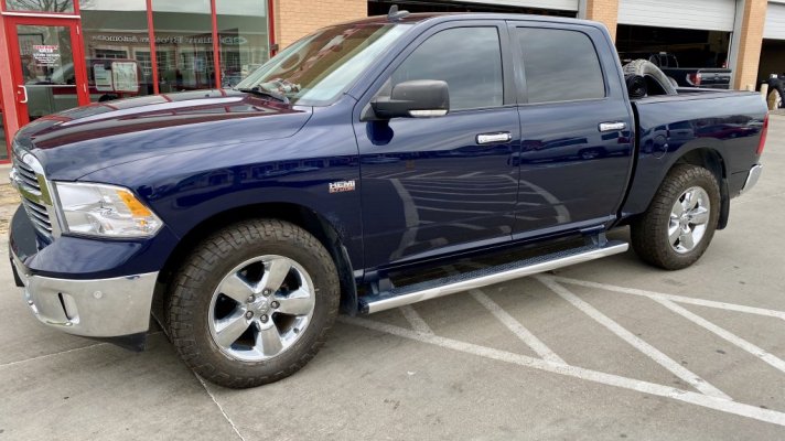

2" spacer lift when I bought it with stock sized tires
Bilstein's set at 2.8" up front with RC forged UCA's, stock in the rear. Nearly worn out 275/60/20s
Now with 35x11.50x20 Nittos. Truck is 1/4" lower in the front, perfect

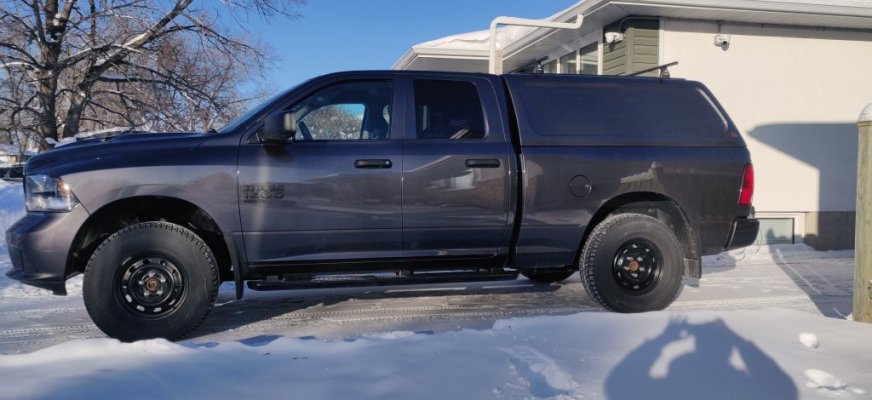

Stock height, brand new 275/65R20s Cooper AT3 XLTs. Debadged.
Bilstein 6112s @ 2.8” and ReadyLift UCAs front, Bilstein 5100s and MotoFab 1.5” spacers rear. Still have 1 1/8” of rake which is about what I was aiming for. (Some Icon 1.5” rear coils on the way.)
EDIT: Measured again after alignment, rake is closer to 1 1/2". The 2.8" seems to have net'd only about +2 1/2" in the front only a day after install--so, I expect it will settle even a bit lower. Regardless, I like the way setup looks now. I may add a 1/2" spacer on top of the struts once Icons are swapped in for the rear spacers depending on where everything settles.
Also put on some 1/2” Titan wheel spacers with hub rings to widen the stance on my stock 20x8s.

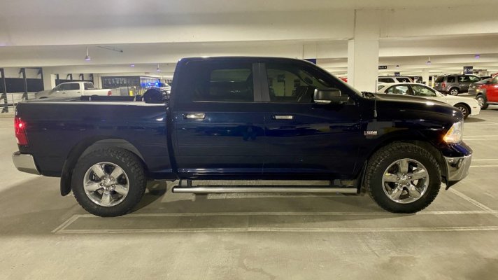

5100s 2.1 front, +35% capacity coils and 5100s rear. There is about 600# in the truck between back seat and bed and it sits level so I will probably throw some trim spacers in the rear.
