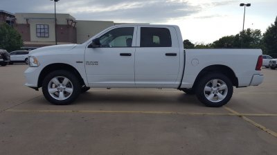

I'm pretty sure there is no level kit on this truck, I can't see any kit when looking up the front coils. I have 1 1/2 inch rake 2014 1500 4x4. Front measure 38 1/4 and rear is 39 1/2.

Bilsteins on there?

Factory shocks in front

Must have spacers or something. Assuming you got it used but it definitely didn't come from factory like that (although I wish they did!)

There's definitely some kind of leveling kit on there

The front kit is hard to see when installed. I had the same question when I got mine and had to touch the top of the spring to realize it had a leveling kit on it.

Definitely leveled. Mine measured
Before
Front 36
Rear 38 1/2
After
Front 39 3/4
Rear 40 1/2

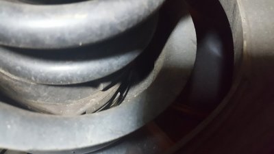

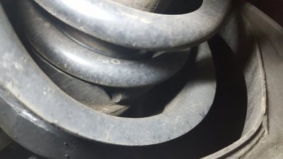

Does the top of the front shocks site directly on the metal inside the upper "cup" or is there a small something that fits in between? The rears definitely do not have any spacers, but the fronts I'm not 100 % positive, it doesn't look like any spacers I've seen. and really doesn't even look like a spacer, but i could be wrong

These are the best pics I could get what do you think, the pic on right shows best what i was referring to, looks like it has some kind of groove that the studs would fit through but in person it doesn't appear to be metal, but im not 100% sure, and i can't find any leveling spacers online that look similar

Could be the Daystar comfortride Leveling kit. Their kits are Poly! It's def leveled tho!

Looked again this morning, and I guess it has spacers, fabtech i believe, suppose I'll swap for bilsteins, any guess how much difference I could expect at 2.8 with 1 inch rear spacer

Probably will raise the front about an inch +/- .250"
I'd install the bils then drive it around a bit for them to settle , get an alignment then decide on the rear coil spacer that you need .
You may not want a spacer at all , or maybe you'll decide on a 3/4" spacer ...
