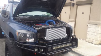

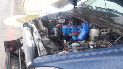

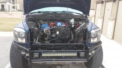

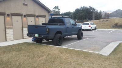

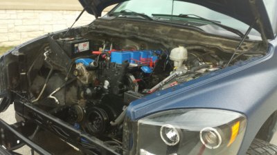

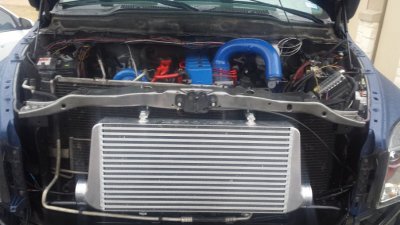

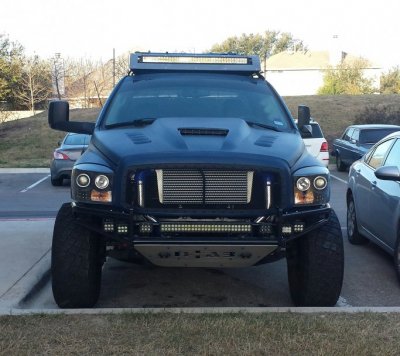

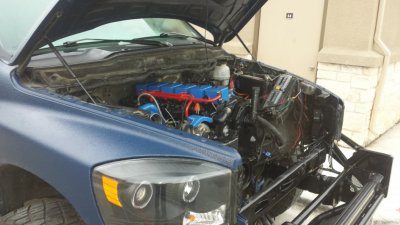

Been working on it for a while but I just put the motor and Trans in yesterday. 1990 5.9 12 valve Cummins with a 727 trans into a 2007 ram 1500 quad cab half ton. Royal ***** to get it mounted, took 10 hours but motor and Trans are bolted.
So am I technically a 1st Gen guy now? Lol

I don't know, does it run and drive? Pretty cool if ya ask me.....
derekp
derekp
Mar 10, 2015
2,131
1,791
Buda, Tx
1990 5.9 Cummins
Not yet but it will. Motor and Trans were running when I pulled it from the d250. I still have little things to do before it'll run and drive.

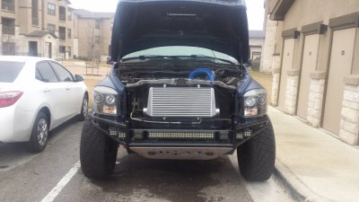

Getting closer...

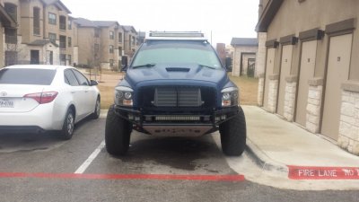

She runs and drives. Drove her around today and got up around 65 mph. Still have a few small things to do but it's getting there.

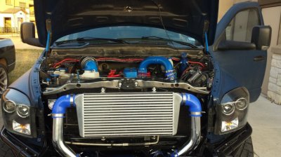

How the engine bay looks now.
