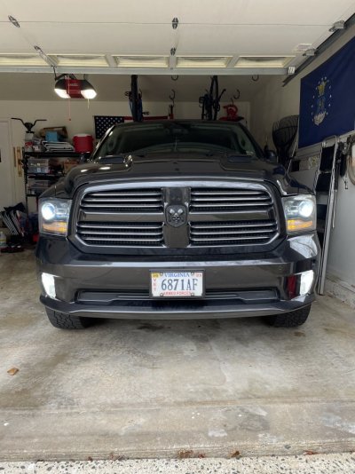

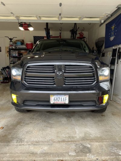

Jrod
USAF 1997-2008
May 19, 2014
1,291
1,470
Virginia
2025 Laramie
SST SO
I wanted both options, so I went with switchbacks. I also deactivated fog light dropout when my auto high beams activate to prevent them from switching colors on their own.
