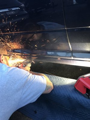

I’m 210 my buddy is 230 we walked up and down? Bounced rocked and did everything humanly possible with spacers and engineering thoughts. No other way around cutting the pinch welds on my truck
