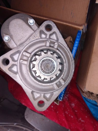

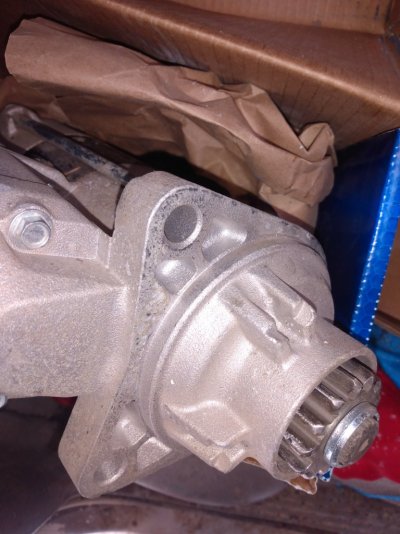

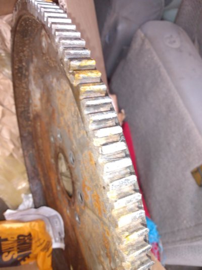

Here's the culprit,car quest starter, not true the flexplate. I replaced the flexplate and the starter. Then I noticed that the new starter is machined to fit the inside of the starter hole. As you can see no machining on the used starter bad fit. Just enough to grind off so it just spun didn't in gauge the flexplate.
