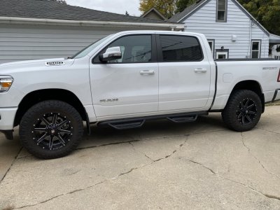

Another 3.5 Readylift

89CDA471-190F-4299-A667-FA72118306DD.jpeg 3.5 Readylift with ORP springs instead of preload spacer. 35x11.5x20 Ridge Grapplers

Did your setup remove the factory brake, I'm not a fan! Your truck looks great btw!
I’ll try to get a better picture. As for the factory rake, I think there’s still a little but definitely better than stock rake. I’d have to measure again

Did you read the notes from Readylift regading their 3.5" SST kit ? ?
NOTE: Not for use on trucks that are factory pre-lifted/leveled or that have the "off-road package". Check factory height prior to ordering or installing. Trucks with more than 22.5" of wheel hub to fender lip height may require less lift.
Note: NOT intended for off-road use or abuse.
Why not do 5100's at #5 if you have the ORP springs? Cheaper than this kit and you can offroad with it.
I used ORP springs INSTEAD of preload spacer. I would have used 5100’s but they were out of stock everywhere I checked and I didn’t know when they would be available. Ready lift came with UCA’s for the front so I was good with that deal. Yes, if Bil’s would’ve been available, I probably would have gone that route.
