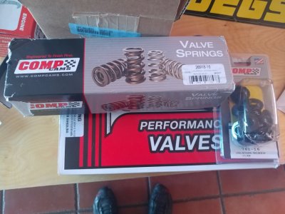

Got all of my gaskets in today and I discovered that the morons who "fixed" my heads ruined them. Turns out that they glass bead blasted my heads. Normally that's a great thing until they decided to blast the machined rocker support surface, you know the one that has to seal for the oil to reach the rocker arms. Not to mention they didnt see what was written on the valve seal packages. One pack being exhaust and one being intake. Yea they put all the intake valve seals on one head and all the exhaust valve seals on the other head. So basically the village idiot assembled my heads. I think at this point im screwed.

Wow that sucks. Hopefully you figure something out. Those are the 6.1 heads right? If they ruined them hopefully you get them replaced!
These valve seals? I thought they all used the same seal?

The rocker shaft mounts should be fine, just make sure there are no beads stuck in the oil holes in the stand .
take the heads back (or find a Hemi friendly shop) , and have them redo the valve seals.
Those are the seals for the intake. The seals for the exhaust have a black seal.
