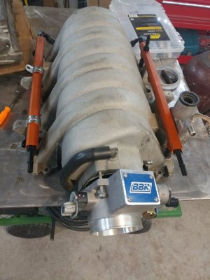

I've got a 6.1 intake on the way. Found that for $300 shipped. I just hope the 87mm bbk throttle body I bought months ago will work on this intake. Ill be using cosmetic gaskets and arp head studs.

Look what came in the mail today! Not too bad for $300 shipped
