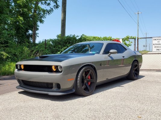

I bought a new PW about a month ago and thought something was wrong with my brakes. Had the dealer look at them and they said they are fine. Don't like them at all. You really have to push them to the floor. And then I get in my Hellcat and those brakes want to throw you through the windshield.

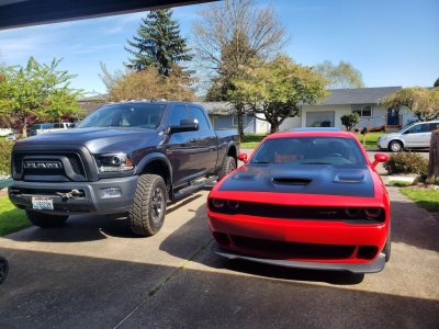

Wish the power wagons had the 6-piston brembo's like our hellcats do, however the rotors are damn expensive to replace.ty.jpg
