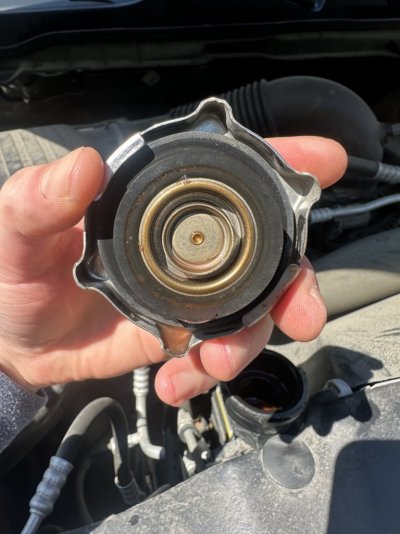

2016 Ram 1500 w/ Hemi. Just about 61k on the clock and I've been chasing problems all winter. First it was (and still is) an electronic steering issue. Then I had the exhaust manifold bolt problem. Now, I have a coolant issue.
Girlfriend borrowed it a few weeks ago for work and came home saying it smelt sweet after she got out of the truck that afternoon. So, it smelt like a coolant leak. I checked the reservoir (not under the rad. cap, unfortunately) and it was bone dry.
Filled it to the max line with Prestone Max, it's kind of purple/pinkish. I'm not sure what color was in there before. I let it sit for 24 hours to see if it would leak from the reservoir and it didn't seem so. I then started the truck up and let it idle for about 20 minutes. Couldn't smell anything or see any leaks anywhere. Drove it for about 5-10 minutes, enough so it got brought up to temp. Got home, let it idle and could not smell anything or see any leaks. I let the truck cool and it seems like the same amount of fluid is in the reservoir.
I am not sure how much my girlfriend drove it after she started smelling it but she said no alarms came on that indicated overheating. Other than this, the truck seems to be running fine. I am attaching photos of the bottom of the radiator cap and opening as the coolant definitely looks funny...but I'm not sure if thats just because I mixed potentially two colors when refilling it. What do you guys think...should I be worried that there's oil in there? Ugh. The dealership I bought the truck from told me "I might have just gotten a bad one..."

Mixing coolant types is a very bad idea, as is using the wrong type ofcoolant. I would use clean water to flush it all out, and fill with the proper coolant. I would also pressure test the cooling system. Far and away the easiest way to tell if you have leaks when you can't find fluid leaking out. Are you getting white smoke from coolant leaking into the combustion chambers? Does your oil look milky?
Yeah, not knowing what was in the before was tough. I did try to get what I thought would be next best to the MOPAR direct replacement without going to dealership to get MOPAR. I probably should have just done that, huh?
I can try to look into a flush. I'm a bit mechanically inclined but not very and have never done that.
I do not see any white smoke from the exhaust or anywhere and last night after driving it, I did not see any milky looking oil.
