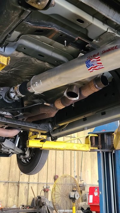

I had some severe vibrations with a previous driveshaft so I had one made and it was a night and day difference. I am now convinced that the engine needs better mounts/chain.
You could do both sides,but the pass side usually isn't done as the motor puts all the load on the drivers side mount when you're in a forward gear. There were rumours floating around awhile ago about solid mounts for the trucks,but i don't know if anybody ever got around to manufacturing them

Did you have the driveshaft checked for balance even though you can't feel anything. Cuz I'm sure at 133 with everything else going on your truck is probably not Cadillac smooth anyway so you may not notice a vibration.

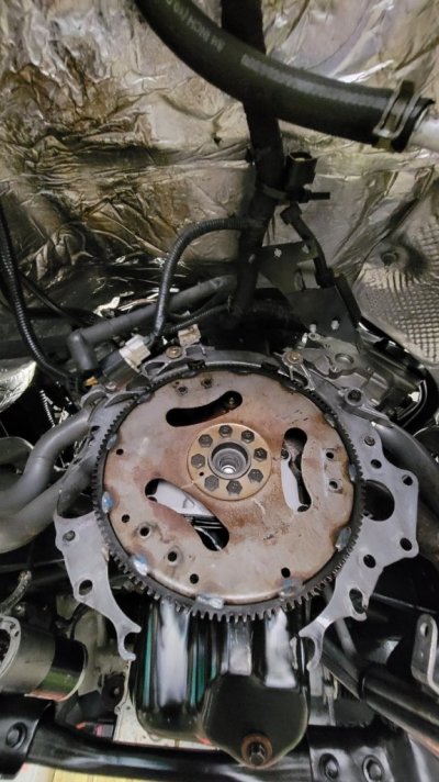

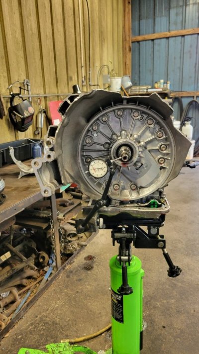

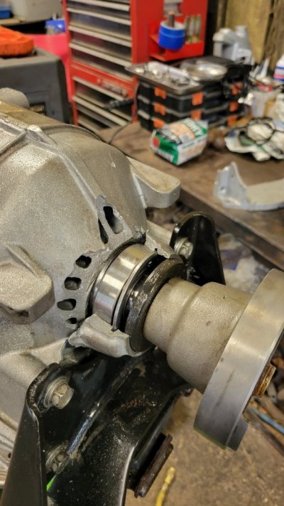

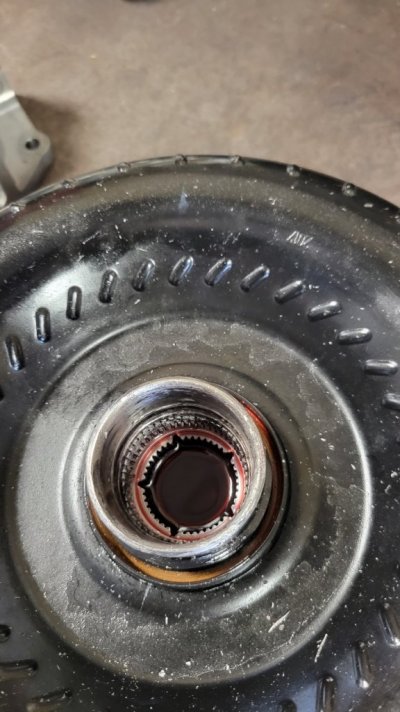

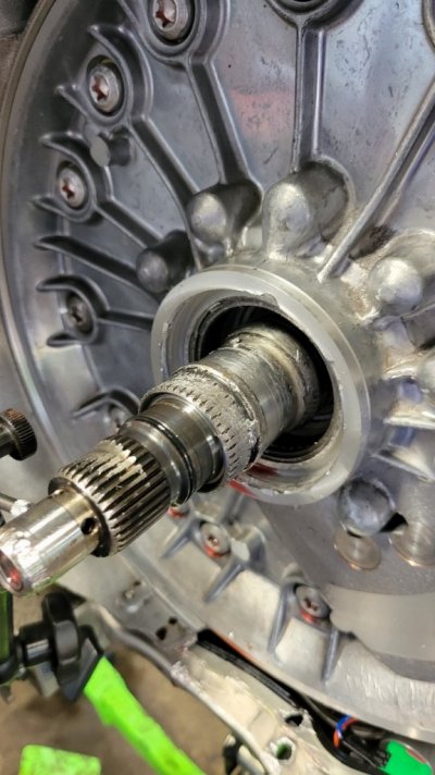

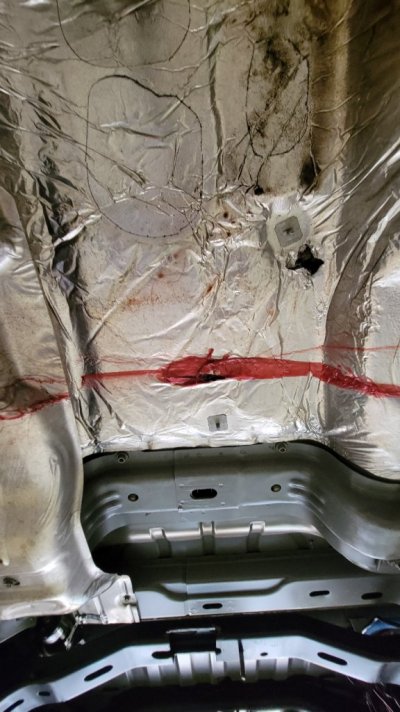

I found out that these aftermarket stroker cranks require a $20 pilot sleeve for the torque converter. I am hoping this was the cause of the transmission destruction. Here are a few pictures of the destruction, viewer discretion advised .
