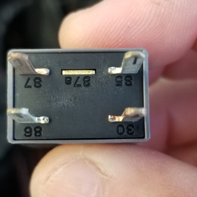

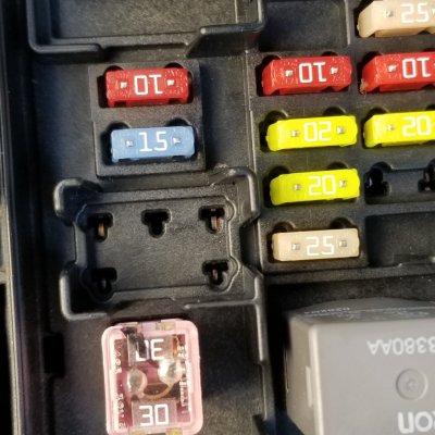

Does the relay legs always match the holes, even when the middle leg is cut off? The AAA guy was playing with them, and I wanted to make sure they are in the right position.

There’s no contact showing in that center hole of the socket, you’re good.
