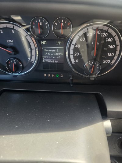

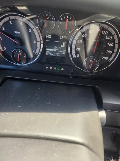

I got around to trying the 3.7 e fan mod on my 2009 5.7.
Yesterday was the first long drive I did on the 401 which was about a 2 hr trip.
My fuel consumption improved significantly from average 18.7 l/100 km to the reading in the picture 14.6 l/100km and coolant temp stayed steady at 95°c , oil temp 98°c and trans temp 67°c .
Temperatures are a little lower while driving around in town .
Any thoughts ?
